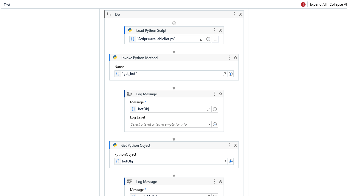

I’m using load python script => invoke => get python object => log message
i ran my script in code editor and it worked and it returned a single string
here is my get python object set up
You are getting error on which activity is it on python scope then check python path you configured correctly?
This part suggests that issue is with calling python method. looks like the variable you are using is null.
could you run this workflow in debug mode and see what activity it is failing and from local panel, verify that variables have values assigned?
