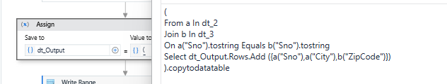

Hey @Christina_Ilkjaer_Peterse so if i’m not wrong you are try two match two datatables
if yes you can use join Linq query to get the matches data.
From a In dt_2
Join b In dt_3
On a(“Sno”).tostring Equals b(“Sno”).tostring
Select dt_Output.Rows.Add ({a(“Sno”),a(“City”),b(“ZipCode”)})
).copytodatatable
so you can customise your column name as per nees dt2 dt3 and dt_output is a datatable variable . to write match data into excel pass the dtoutput var dt1 and dt2 holds the data of excel1 and excel2 .
The image depicts a UiPath sequence that involves reading two Excel sheets, assigning their data to a variable, and writing the combined data to an output sheet. (Captioned by AI)
cheers Happy Automation
