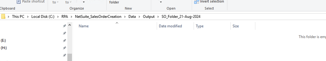

I am getting the below error when using write range activity inside folder. What is missing from my side in the below expression.
in_Config(“OutputFilePath”).ToString+“SO_Folder”+““+now.Date.ToString(“dd-MMM-yyyy”)+”"+in_Config(“OutputFileName”).ToString+"”+System.DateTime.Now.ToString(“dd-MM-yyyy hh:mm:ss”)+“.xlsx”

  1. \ was missing between OutputFilepath and SO_Folder
  2. The file name dd-MM-yyyy hh:mm:ss should not contain special character : as it’s not allowed by Operating System. I would suggest to use - or _ as value separator.

Thank You . The error was mainly due to The file name dd-MM-yyyy hh:mm:ss should not contain special character :.
\ was there in the Output file path in Config sheet
