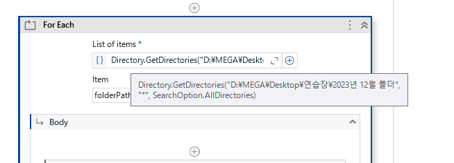

Can you try to remove FolderPath In as the following?
Then this code is not copied to the subfolders of the folder. Is there a way?
HI,
Can you share what you want to achieve?
At least, as FolderPath is overwritten by the assign activity, it will be fixed value every time.
How about to remove this Assign?

How about the following?
exception file_copy folder.xaml (10.4 KB)
solved. very thank.
