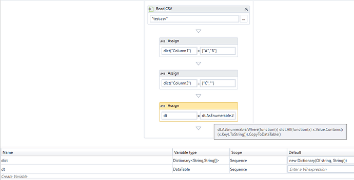

If you want to filter datatable by dynamic multiple condition with single line, the following might help you, for example.
You can just add dictionary item if you want to add condition.
dt.AsEnumerable.Where(function(r) dict.All(function(x) x.Value.Contains(r(x.Key).ToString))).CopyToDataTable()
Note: This way is high maintainability but might not be very fast.
