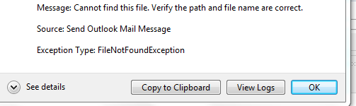

I am getting a file not found exception when sending an email with attachments - even if the folder contains files.
Thanks

I have the following passed in the invoke method
Still it throws FIleNotFound exception.
Also I ran the code in another computer with Uipath Studio and it works fine , It throws this exception when on a Front-office PC
So that means no problem with code
@saivig
System.IO.FileNotFoundException means the program did not find the file you specified. So please verifies the directory path you are passing is correct or not.
Regards…!!
Aksh
Found the issue- Uipath Package Mail Activities - Reinstalling it did the trick.
