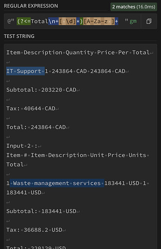

@Sachin_P
Please try this
System.Text.RegularExpressions.Regex.Match(str,"(?<=Total\n+[ \d]*)[A-Za-z ]").Value.Trim
Hope this helps
Yes it works exactly how I wanted,
Thanks.
