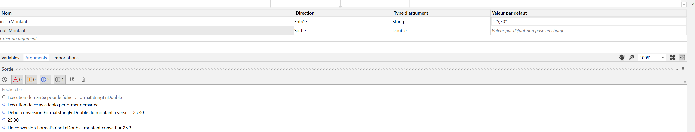

did not work: for exemple for a string “1 510,18 EUR”, it gives 1 as a double
the code is attached
FormatStringEnDouble.xaml (12.9 KB)
try this you will get the output
i did not see your suggestion !
Worked fine for me.
CDbl(System.Text.RegularExpressions.RegEx.Match(myStr.Replace(" ","").Replace(",","."),"\d+(?:[,.]\d+)*").ToString)
