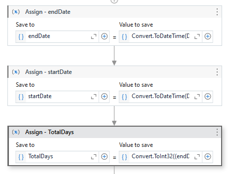

Use the below method
endDate=Convert.ToDateTime(DateTime.ParseExact("11/10/2022 1:42:00 PM", "MM/dd/yyyy h:mm:ss tt", System.Globalization.CultureInfo.InvariantCulture).ToString("MM/dd/yyyy"))
startDate=Convert.ToDateTime(DateTime.ParseExact("10/20/2022 1:42:00 PM", "MM/dd/yyyy h:mm:ss tt", System.Globalization.CultureInfo.InvariantCulture).ToString("MM/dd/yyyy"))
TotalDays = Convert.ToInt32((endDate-startDate).TotalDays)
Variable Type
Way of Implementation
Output
Thanks,
Sanjit
