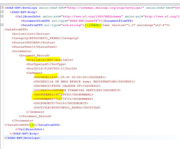

Hi ppr, thanks for your help, txt file of xml from UiPath is attached, the detail data i need to extract is Status, DOCDATE1, DOCNUMBER1, DOCNUMBER2
<SOAP-ENV:Envelope xmlns:SOAP-ENV=“http://schemas.xmlsoap.org/soap/envelope/” xmlns:SOAP-ENC=“http://schemas.xmlsoap.org/soap/encoding/”>
SOAP-ENV:Body
list R55U03B501_PXPKG SUCCESS YES pdf 14-81847883-1 2021-09-30 00:00:00 A OK SMOG REPAIR & REGISTRATION 46590 CALHOUN ST CUSTOMER FINANCIAL SERVICES 38729845 71277470 70018 R55U03B501_PXPKG ]]>
</SOAP-ENV:Body>
</SOAP-ENV:Envelope>
Please confirm that the shared XML is of this format:
escaped XML as values. If so, then we would first decode the value, parsing and Xml processing it.
Yeah the request is html encoded, but the result format within SoapUI looks fine, not sure why in UiPath the format changed.

So when again Parsing the XML we can access:
grafik
It is about the handling the CDATA Part
But with a second Deserialize XML it can be handled as show cased above
