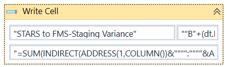

Is this correct? I am running into an exception.
I think your range is wrong. Looks like you have extra quotations.
“A1” is your normal range so you are just replacing the 1 with a variable, like…
“B”+variable
and “variable” can be the .Count of the rows, so …
“B”+(dt.Rows.Count+2).ToString
with “dt” being the variable of your dataTable
If this doesn’t help resolve it, then let us know what exception you get.

I am creating a Read Range activity from “B12:B6000”. Then I am creating a Write Cell activity and the range is defined as “B12”+(vRowCount.Rows.Count+2).ToString and the formula is defined as “=SUM(INDIRECT(ADDRESS(1,COLUMN())&”""":""""&ADDRESS(ROW()-1,COLUMN())))"
Below is the exception. Thanks again guys. I’ll try your technique Aksh if I understand it :slight_smile:
You could try hardcoding your range to test it with “B6002”
You will need to make sure that vRowCount.Rows.Count gives you the correct value before that activity.
Your range field should look like this:
“B”+(vRowCount.Rows.Count+2).ToString
which would be “B6002” assuming the .Rows.Count is correct.

When you put in the Row.Count it should look like this:
Assuming your Sheet name is correct and that vRowCount is your dataTable variable.
(I only show errors cause I haven’t declared those variables.)
Also, verify that vRowCount.Rows.Count gives you the correct number before the Write Cell, if you still get Range Does not Exist.
