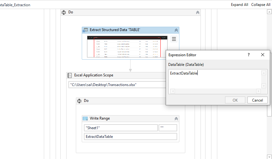

Hi @jimmy_jos1
Make Sure Extracted Output Data Table name and Write range Input Data Table name are same

The error has raised due to the initialization issue of some variable. You can spot the variable first that has been causing issue and then set some default values to that particular variable. Also try changing the variable type to generic.
Reason for it because variable is null, Initlize Variable will resolve issue
