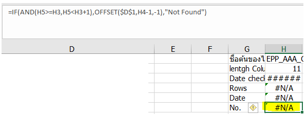

I want to read cell H6 (highlight yellow)
In cell H6 sometime show #N/A or number.
But show error Read Cell: #N/A is not a valid value for Int32.
Please guide me about it.

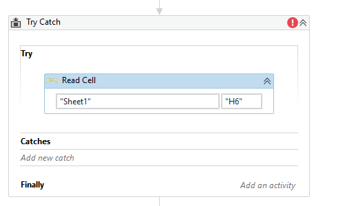

You can use Try catch activity and place Read cell activity
Hope this may help you
Thanks
@Srini84
How to set try catch?
@fairymemay
Can you tell me what you want to do after Read Cell activity also what type of exception you are getting in the error
That you have to select in Catches and give your activities you want to do when exception hits in that block
Thanks

Try as below
First get the exception type you are getting in Read Cell
Surrond Read Cell with Try Catch, In Try Declare a variable as below
In Catches select the exception and place as below
Now use If condition as below If exception hit or not
Thanks

You are debugging the workflow, Debug always stops in error even if surrounded by try catch, try to run the workflow and you will see catch is executed
Thanks
