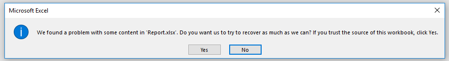

After run macro using invoke VBA , If I open file it show popup found problem about report always causing the program to not work in the next step as below.
Please guide me for solve it.

Does the macro run correctly in manual testing?
Your screenshot shows an xlsx extension. Is it generated by the macro ? Macro files usually have an xlsm extension.
You can use Execute macro activity instead of invoke VBA. Have you tried it?
@AndyMenon I can solved it by remove filter -----> It not error.
