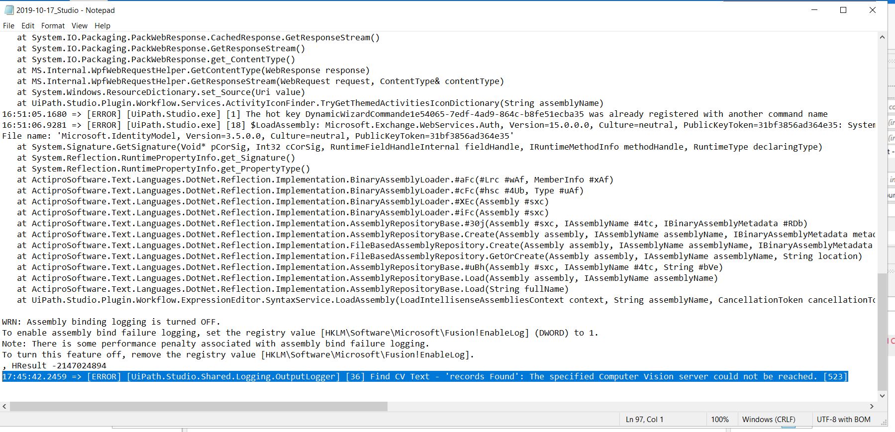

I do not find any %localappdata%\UiPath\ComputerVisionLogs folder
The error occur randomly at any time any dates as from more that 2 hours of process run.
I will run the process Now and will report you the error log - time etc.
