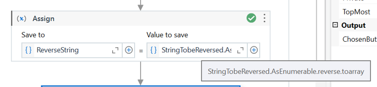

  • Lets see now the implementation in UiPath*
Step 1:- Drag an assign activity and pass a value that you like to reverse.
Step 2:- Drag another assign activity and apply the formula to reverse the string.
Step 3:- Drag message box and print the result.
Step 4:- Run the workflow now.

string.Join(“”,str_text.ToCharArray.Reverse)
