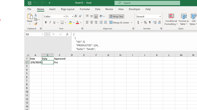

Can any help to deserialize CSV to Data table. And in CSV Sheet cell B2. the data is available in JSON format.
Screenshot -
I used deserialize JSON & Deserialize JSON array activities to perform but getting errors. and unable to write it in Data Table.
Attaching an screenshot for output reference.

Here is the JSON data, which is available in cell B2 in CSV sheet.

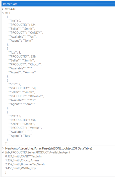

For conversion of the JSON into a DataTable we can do:

Hi
I want to deserialize the cell B2 in CSV. I used Read CSV activity then I created a variable using assign activity which will read cell B2 value. However I still getting errors when I using deserialize JSON activity after that.
Regards
Naman
@vrdabberu
I understood the concept behind deserialize but my concern is to read a CSV and particular cell value which is available in json format and deserialize it into a new data table.
