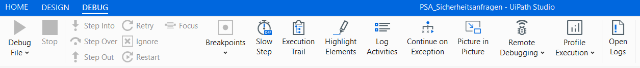

Debugging greyed out
debugging worked and then probably I clicked on sthg and then debugging shows like this:
What do you suggest to click to be able to debug again?
Thx and KR, Vanja

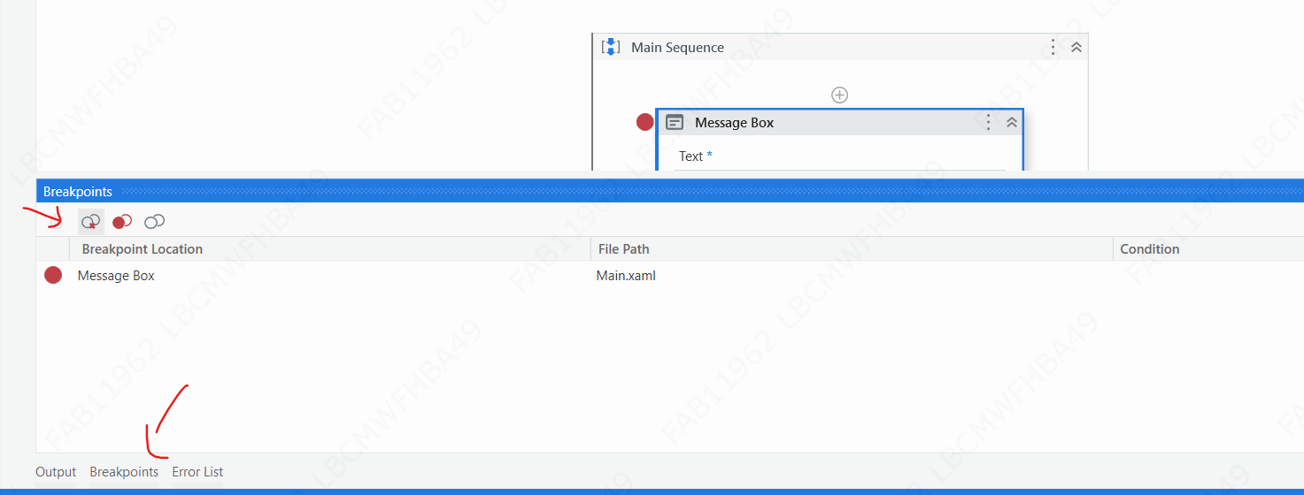

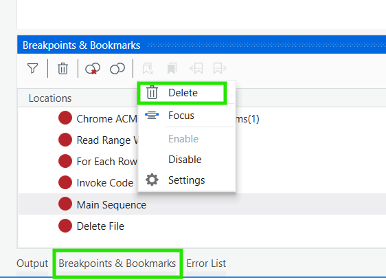

Hi, thx for all suggestions. It has to do sthg with breakpoints. How do I deactivate it?
@VanjaV
Right click on the main sequence and hit delete
Or
Click on the outer main sequence and click F9 twice
Hope this helps!
For removing all the breakpoints ,
Click on breakpoint section at the bottom and delete all by clicking the below highlighted option
Thx. I did deactivate / delete all breakpoints. But the problem still exist. When I press debug, it happens nothing. :frowning:

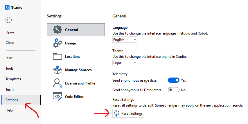

Another suggestion to test out before reinstalling could be to reset settings to default in UiPath Studio.
Great Thx to everyone!
Unfortunately I did reinstall before two last comments and now it works.
Remark on 11.9.2025
Today I had the same error and reset Settings as suggested from @SorenB actually worked! This is the real solution to the problem! Thx
