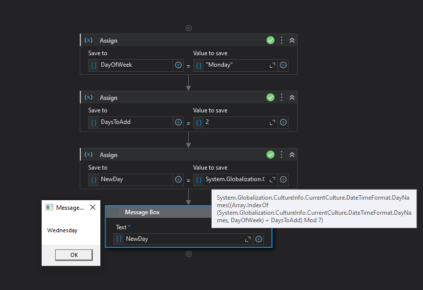

Hi @Maria_Ines_Almeida,
Here’s how you can solve it:
I put together a workflow for this—adding the screenshot for you to check out. You just enter the starting day and the number of days to add, and it gives you the correct day automatically. For example, if you start with Monday and add 2 days, it’ll give you Wednesday as the result.
Here is the code:
System.Globalization.CultureInfo.CurrentCulture.DateTimeFormat.DayNames((Array.IndexOf(System.Globalization.CultureInfo.CurrentCulture.DateTimeFormat.DayNames, DayOfWeek) + DaysToAdd) Mod 7)
This way, you don’t have to enter the days manually; it’ll handle it all for you. Let me know if this helps!
Furkan

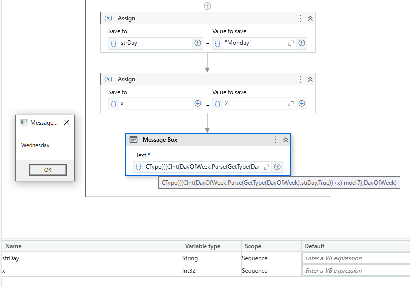

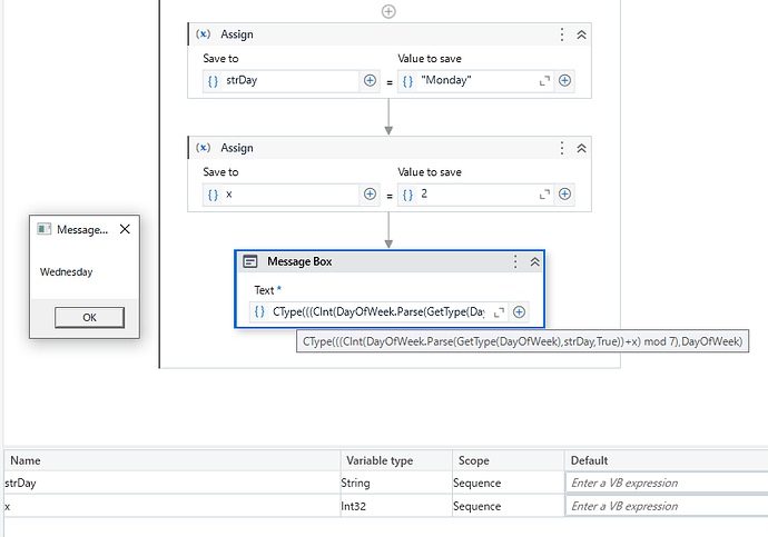

FYI, another approach:
strDay = "Monday"
x =2
Then
CType(((CInt(DayOfWeek.Parse(GetType(DayOfWeek),strDay,True))+x) mod 7),DayOfWeek)
(This returns DayOfWeek type.)
OR
CType(((CInt(DayOfWeek.Parse(GetType(DayOfWeek),strDay,True))+x) mod 7),DayOfWeek).ToString()
(This returns String type)
