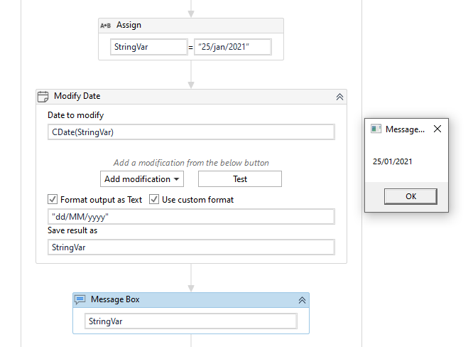

There is an activity in UiPath called Format Date, which can be used to manipulate dates in a DateTime format. You can use a preset format to write to, or you can specify a custom format.
Try using this activity to format your date. If your date is a string, you can do CDate(StringVar) to convert it to datetime.
