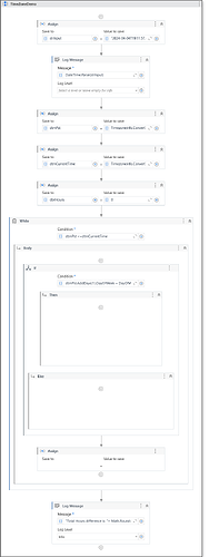

@anjali123,
Here is one approach which will give you total hours difference between input date in UTC and current date in PST.
Sample code:
TimeZoneDemo.xaml (11.9 KB)
Thanks,
Ashok :slight_smile:
