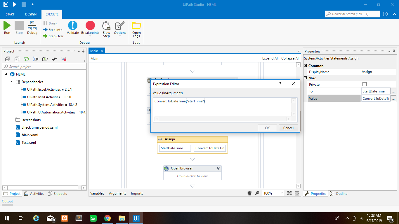

I want convert the string to datetime variable
Supriya

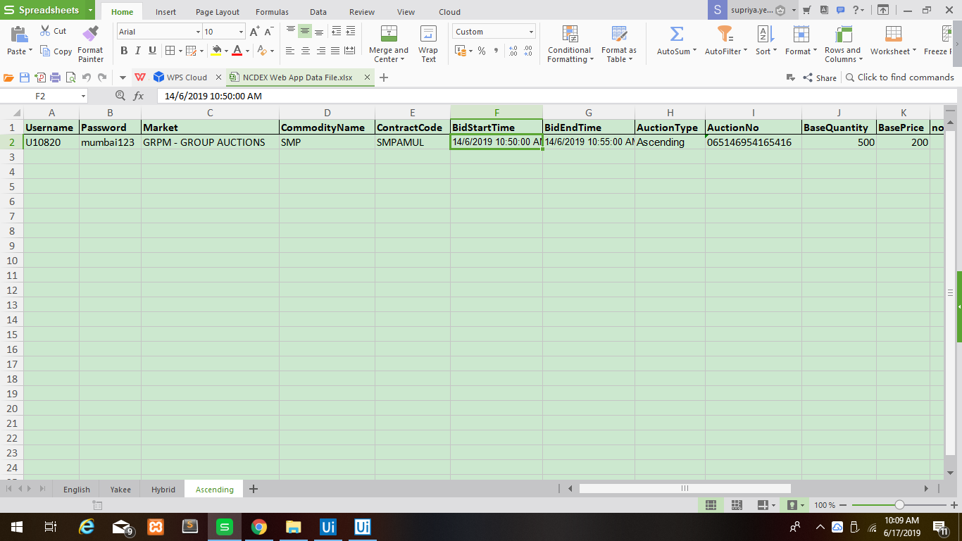

First try to print value from Excel and check the format once. And also show me your expression once.

Hi @
In the screenshot you have given start datetime in double quotes and use it as normal startdatetime
Thanks
Ashwin.S
Hii
StartTime is a string
StartDateTime is a DateTime variable
I need to convert startTime to StartDateTime
Supriya
Try this:
DateTime.ParseExact(startTime,“dd/M/yyyy HH:mm:ss tt”,CultureInfo.InvariantCulture)
Where startTime is of type String and input is coming from Excel file. Create one DataTime variable and store above expression result into it using Assign Activity.
Create a variable as culture info and declare the type as culture
