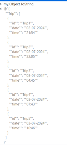

JSON deserialization:
grafik
grafik
myJObject
So we can check how much we can grab by out oft the box conversions (we recommend to confirm, that day, month position are crosschecked, where exact is the day?)
grafik
TimeSpan is Failing, but can be handled in that way:
grafik
So we can use LINQ and order to the relevant JObject

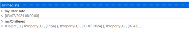

grafik
grafik
myJOFiltered =
(From jo In myJObject("Trip").Values(Of JObject)
Let dp = jo("date").Value(Of DateTime)
Let dt = TimeSpan.Parse(jo("time").toString)
Where dp = myFilterDate.Date
Where dt <= myFilterDate.TimeOfDay
Order By dt
Select jof=jo).Last()
