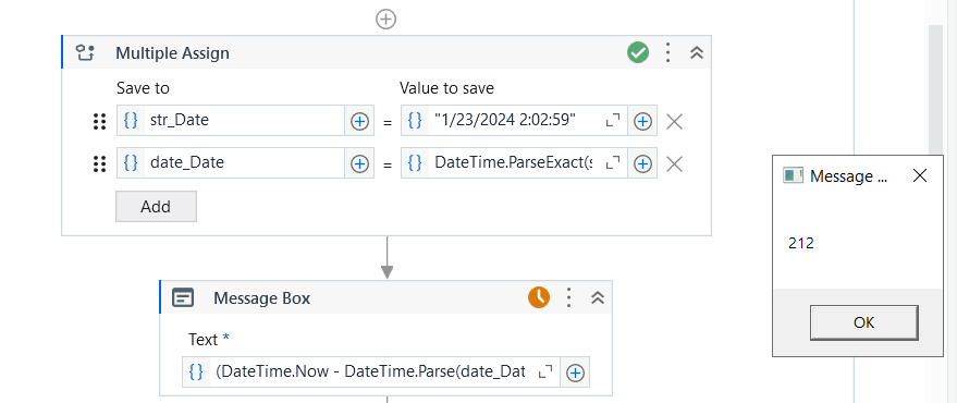

Hi @Aditi0374
str_Date ="1/23/2024 2:02:59"
date_Date = DateTime.ParseExact(str_Date, "M/d/yyyy h:mm:ss", System.Globalization.CultureInfo.InvariantCulture).ToString("MM/dd/yyyy")
Messge Box (DateTime.Now - DateTime.Parse(date_Date)).Days
