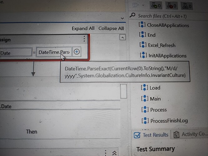

Hi everyone, i got struck in date conversion.
I have a Excel and it have some dates and i need to look for today date in that but I’m unable to match it. Can anyone help me
Code which I’m using is :
DateTime.ParseExact(CurrentRow(0).ToString, “MM/dd/yyyy”,System.Globalization.CultureInfo.InvariantCulture)
But this is not working it is throwing error like string is not valid date time

Hi @Rreddy -
Try this
DateTime.ParseExact(CurrentRow(0).ToString(), "M/d/yyyy", System.Globalization.CultureInfo.InvariantCulture)
Hi @ABHIMANYU_THITE1 getting same error like string was not recognised as a valid date time
Hi @Rreddy - can log there what value you received in the CurrentRow(0).ToString()

Use this -
DateTime.ParseExact(CurrentRow(0).ToString(), "MM/dd/yyyy HH:mm:ss", System.Globalization.CultureInfo.InvariantCulture)
Thanks @ABHIMANYU_THITE1 it’s working.
