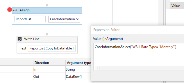

I try to select sume rows from a datatable, and my activity is as below .
but when I debug, it gives me a error message like this
Does anyone know how to solve this problem…
Thank you in advance.

while you column name has spaces then the column name should be inside [ column name ]
then query will be CaseInformation.Select(“[WBill Rate Type] = ‘Monthly’”)
this will give you datatable so the variable in which you store should be of data table type
Wow, I make it by your solution thank you very much~~
Thank you very much for your answer solved my problem~~
