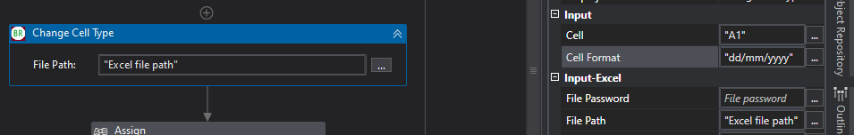

Hi ,
In the release Version 2019.2.0. I have added a new activity called Change Cell Type. It changes the format of the value like below.
[image]
In the Cell Format , can specify the custom format what we have in the excel Like below image.
[image]
Sample : UiPathGoExcel.zip (18.4 KB)
