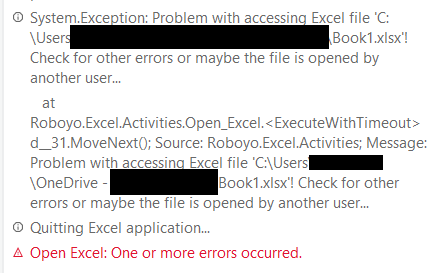

In my visual studio, I have attached what I have, for example, if a file does not exist.
In my UiPath Studio, you can see that I run the code, get a trace log, but still see “one or more errors occurred”.

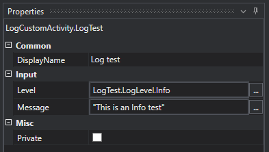

Here my test workflow:
