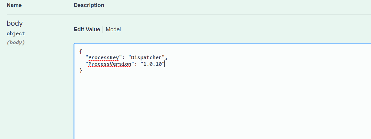

i am passing processkey, processversion in body

Processkey looks like a number with hyphens and all not the name…
we get process key if that process is there in orchestrator process.
