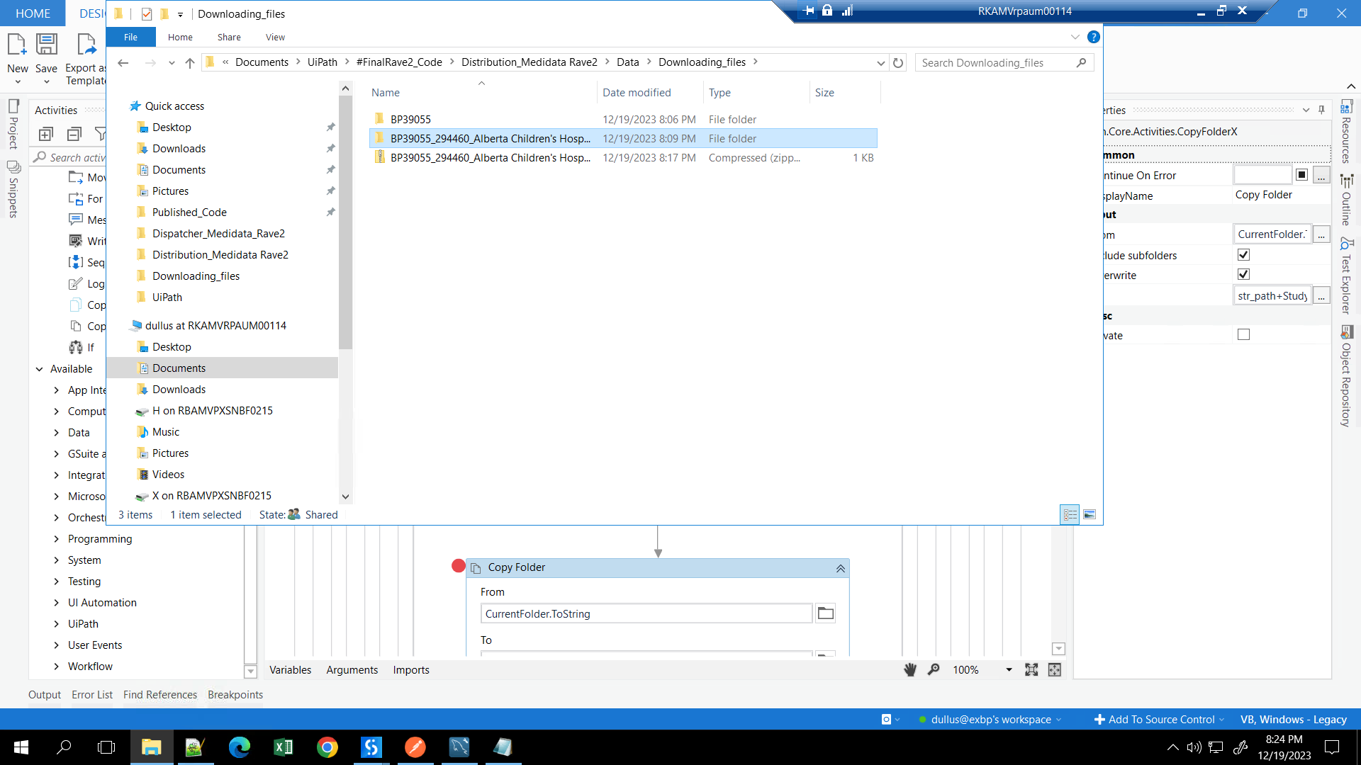

Current folder path is in Watch panel and getting issue while Copying it to other location. Copy folder is placed inside folder in folder activity.

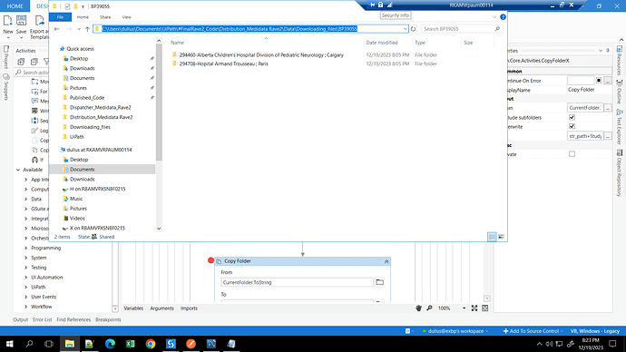

From screenshots - Files starting 294460 and So on i will take the files/Copy the files
And then After copying the files I will paste those file inside inside the Highlighted folder below and after copying Zip the folder as you can see in the last Folder

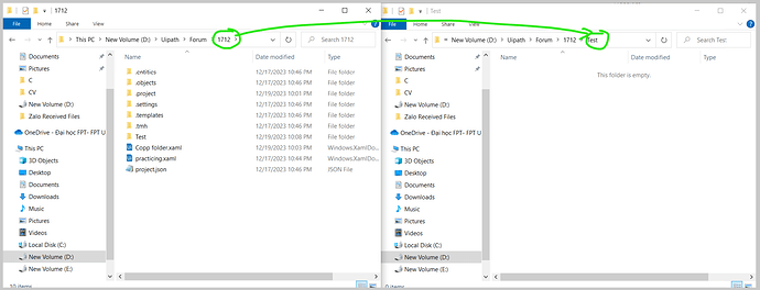

The copy folder does not allow you to change the name so if you want to copy the folder then please make sure the output folder path where you are sending should be the existed one.
please check the below for better understanding.
In the above image the AmazonConnect-master folder is already existed and the 676065 is moved into the AmazonConnect-master successfully with the same name.
