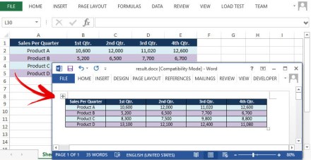

Now I want to copy and paste this table to one word file. the format would be same as it looks. Rather if I can they font and style would be same. This entire operation I want to do using invoke code, and the code would be in C#. Can anyone help me on this. It would be much appreciated, if I could get the help.
Thank you @Jobin_Joy for this, but challenge is , I found this article previously, but I am not able to make it in uipath, as I am not much used to use invoke code. If anyone can help on that how execute this part of code using uipath invoke code. I would be grateful.
Also I did not find this namespace in uipath,
using Spire.Doc;
using Spire.Doc.Documents;
using Spire.Doc.Fields;
using Spire.Xls;
using System.Drawing;
@learning_sourav Please add this by Manage packages and then you can as a namespace. For that press CTRL+P and click on all packages. Search for “Spire.Doc” and install it. Later you can import the Namespace from Imports tab.
Thank you @Raakesh_Chaaloo for helping on this, but unfortunately I could not able to build the design of code, how to do the same. If anyone can share one sample code for the same, I need some guidance actually to do this process thrugh invoke code and if anything require related to that. Help would be appreciated.
