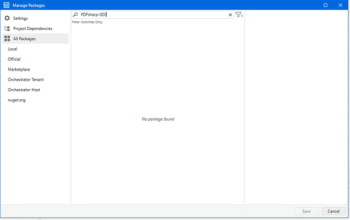

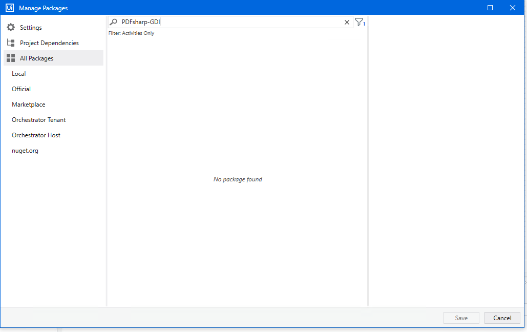

Hello @postwick, where can I find PDFSharp-GDI package?
There is no such package when I search for it, can you please guide?

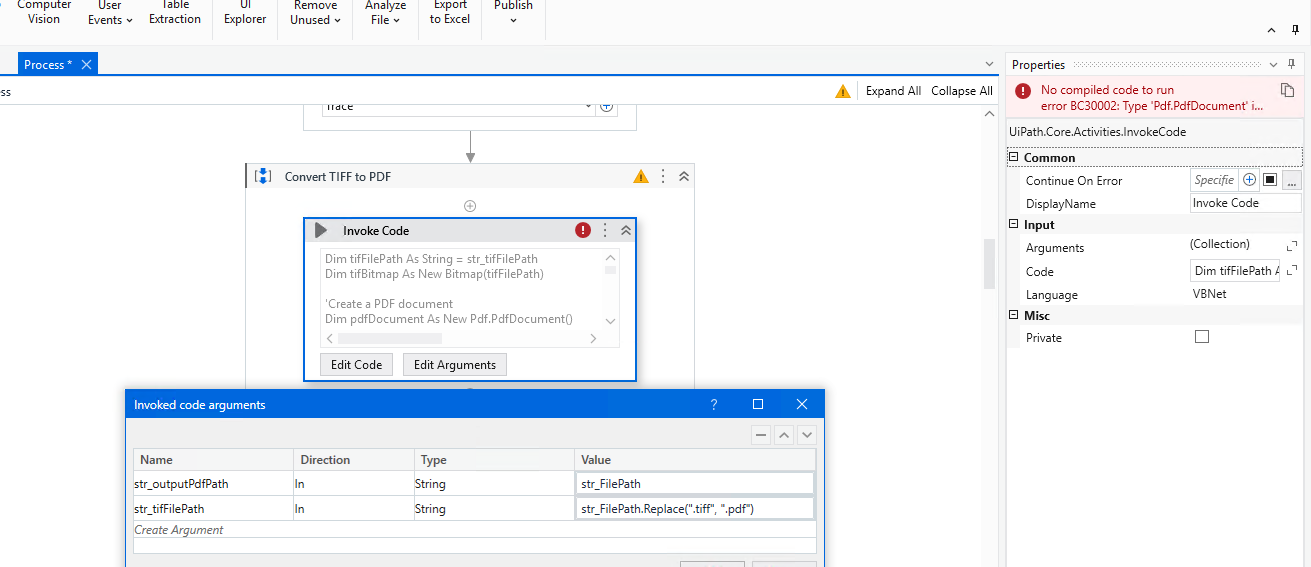

I am getting this error, while I try to use the above code with arguments (str_tifFilePath, str_outputPdfPath) as below
Error Message:
No compiled code to run
error BC30002: Type ‘Pdf.PdfDocument’ is not defined. At line 4
error BC30002: Type ‘Pdf.PdfPage’ is not defined. At line 17
error BC30002: Type ‘XGraphics’ is not defined. At line 18
error BC30451: ‘XGraphics’ is not declared. It may be inaccessible due to its protection level. At line 18
error BC30002: Type ‘XImage’ is not defined. At line 19 Variable ‘Pdf.PdfDocument’ is missing. Please use Data Manager to recreate it.
The errors are because you don’t have the package installed.
Once installed it should look like this:

I do not see it in the manage Packages, do I need to download it from somewhere?
please guide.
I am using Studio 2024.10.12 LTS (Enterprise License -Service mode installation)
Do not search PDFSharp-GDI. Search PDFsharp and then look for the one named “PDFsharp for Windows Forms apps” and “by PDFsharp”. Make sure you specifically install the one named “for Windows Forms apps” as you will get multiple results just from searching PDFsharp.
Also, you have a filter set in your Manage Packages window. Remove that filter to make sure you see all results.

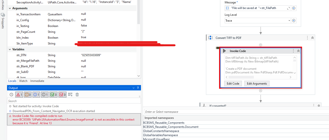

Thank you! There are no errors but when I try to run it, it gives out error
Invoke Code: No compiled code to run
error BC30389: ‘UiPath.UIAutomationNext.Enums.ImageFormat’ is not accessible in this context because it is ‘Friend’. At line 13
This is code for reference:

You’re DIMing variables like tifFilePath and outputPdfPath but then not assigning them values. You should be providing those as arguments to the Invoke Code, then you don’t DIM them.

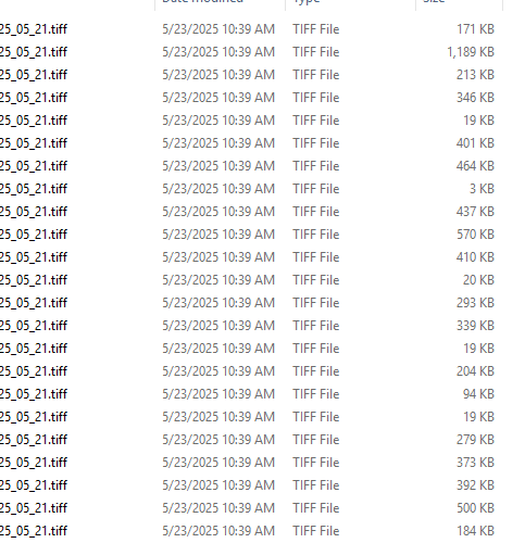

It gives no error, but it doesn’t produce any pdf file
In the logs, it shows as memory out of exception and also attached arguments for reference
System.OutOfMemoryException: Out of memory.
at System.Drawing.Image.FromFile(String filename, Boolean useEmbeddedColorManagement)
at UiPathCodeRunner_15d4b7687942454998c48bdbc81f9699.Run(String sourcefile, String destinationfile)
How large is your TIF file?
It ranges from 171Kb to 1189 kb
How large was the file that gave you the out of memory exception? Are you just testing with one file at a time? Or are you looping through all those files? Did it do any successfully?
I have tested it for one file of 171kb
