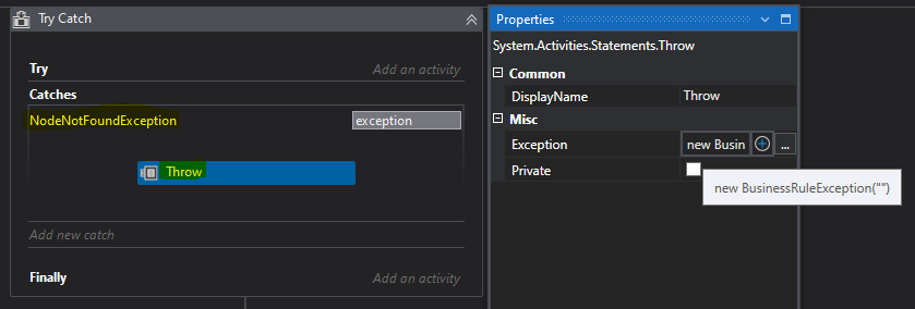

Does anyone know how to convert the type of NodeNotFound exception (UiPath.UIAutomationNext.Exceptions.NodeNotFoundException) to a BusinessRule exception (UiPath.Core.BusinessRuleException)?

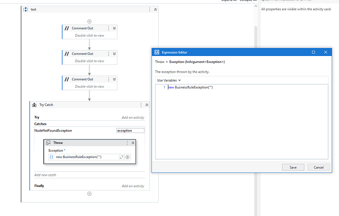

HI @Hai_Pham_Viet ,
bạn thêm new exception là ok mà
Thank you so much for your assistance @Nguyen_Van_Luong1
