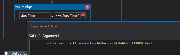

@ppr It worked thank you! Only additional question is that the datetime → milliseconds worked perfectly, however I seem to be getting an error when attempting to convert from milliseconds to dateTime.
The error reads:
Complier error(s) encountered processing expression “new DateTimeOffset.FromUnixTimeMilliseconds(1644271200000).DateTime”. Type “DateTimeOffset.FromUnixTimeMilliseconds” is not defined.
My DateTime variable is type datetime. Any idea what could be occurring?
as it is a static method we do not initiate a datetime
Hi @ppr, thank you for you response again. For clarification, how would this be written in UiPath?
I imagine there’s a specific way to write it as this is giving me an error:
same as done within the immediate panel from screenshot above
assign Activity
LHS: yourDateTimeVar | DataType: DateTime
RHS: DateTimeOffset.FromUnixTimeMilliseconds(yourMSVar).DateTime
Perfect, thank you again! It worked ![]()
