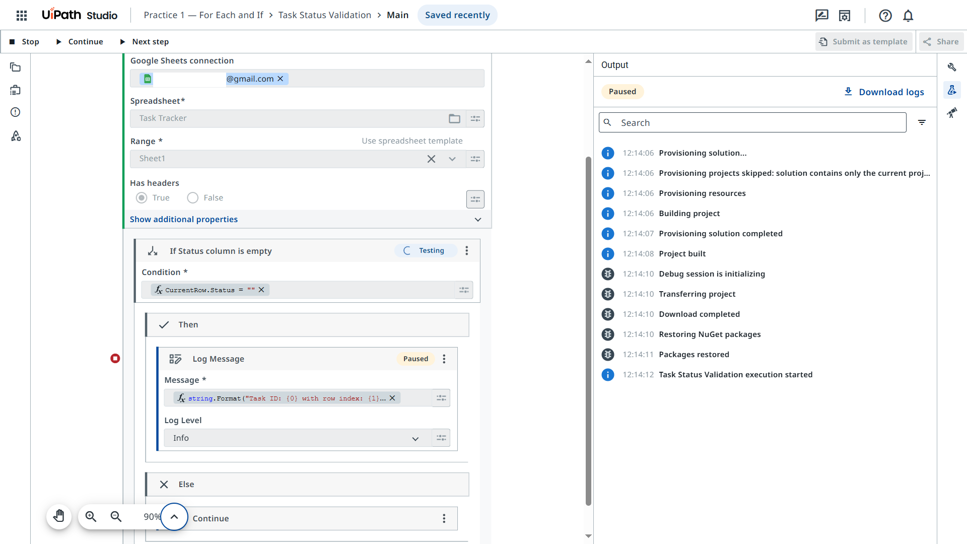

I’m working on Practice 1 — For Each and If in the Control Flow in Studio Web course. I’m trying to loop through rows in an Excel file and flag the ones where the Status column is blank.
I used the condition:
vb
CopyEdit
row("Status").ToString.Trim = ""
But it doesn’t seem to flag all the empty cells correctly. Some rows are being skipped even though the status is clearly blank.
In your if condition use: String.IsNullOrEmpty(row("Status").ToString.Trim)
If block: what you wanted to do if cell is empty.
Else: what you wanted to do if cell is non empty.
Br,
NikZ
Hi @Roopa_Patel , I use the same expression and it works for me.
My expression is: CurrentRow(“Status”).ToString.Trim= “”
Hi @Roopa_Patel.
Same for me:
Regards.
First, I checked to make sure there is actually a Task ID on the row before proceeding:
If string.IsNullOrEmpty(CurrentRow.Task_ID) = false
then I checked the Status:
If string.IsNullOrEmpty(CurrentRow.Status) = true
If no status, log a message.
If no Task ID, then stop processing altogether.
Hope this helps!
in your condition you could try this:
also make sure for the action of the empty rows is default to skip so in case you edited the file and removed also the task id from some rows it will cause the issue for you.
Let me know if you need further assistance
