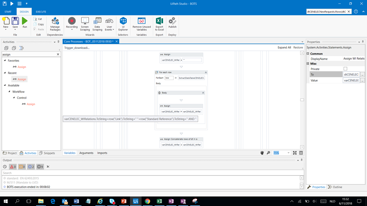

Sorry I cannot share the xaml. I will try to summarize better:
I have a list of projectnumbers for which I need to scrape data from a datatable
For projectnumber 1, this datatable can consist of 3 rows but for projectnumber 2 it can consist of 4 rows (so it varies based on the projectnumber)
But the datatable always consists of 2 columns: “links” and “standard reference”
In this datatable I need to concatenate every row for those 2 columns
It works but for the second projectnumber my output is the concatenation of the first project number + the concatenation of the second project number. This is not my desired outcome for the second projectnumber as I only want the concatenation of the second project number.
Yup. I kinda got most of this from your first post too.
The only check I would do is, are you resetting the value of your string variable varCenelecWIRelations to “” before you start concatenation for the second project?
Okay. If that’s the case, are you reading on top of the existing data table for the second project too? Can you try Clear Data Table before your second project??
