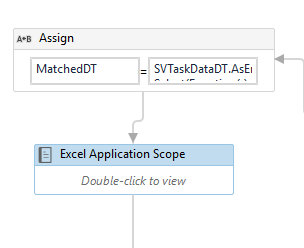

I am trying to compare these two datatables in the following manner. But I am not getting any common rows which I should be. Could anyone provide insight as to what I may be missing here.

Use this query it will return dataTable. You can use datatable.Rows.Count to check the records in the new datatable that query will return.
MatchedDT (DataTable) = Dt1.AsEnumerable().Where(Function(row) Dt2.AsEnumerable().
Select(Function(r) (r.Field(Of String)(0)).Trim).Any(Function(x) x = (row.Field(Of String)(0)).Trim)).
CopyToDataTable()
Hope it will work

how do I output the MatchedDT. I am trying to write range and it doesnt seem to like it. am i missing something
thank you,
pari
first check the rows in the MatchedDT by MatchedDT .Rows.Count.
If count >0 then use write range activity and give MatchedDT as datatable.
