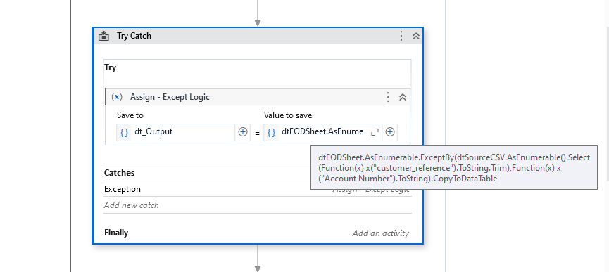

Hey @Josh_James
Try Below LinQ, You will get your expected Output!
dt_Output = dtEODSheet.AsEnumerable.ExceptBy(dtSourceCSV.AsEnumerable().Select(Function(x) x("customer_reference").ToString.Trim),Function(x) x("Account Number").ToString).CopyToDataTable
Note: dt_Output’s Datatype is Datatable. And also you can switch datatable variables and column name respectively as per your requirement.
Screenshot for your reference:
If No Rows found after above LinQ, it will throw error as: No Datarow found
For Exception Handling:
Surround Assign Activity with Try Catch, in Catch take assign and clone the datatable that you need as the output.
It will give output as Empty Datatable cause no Rows found!
In below example I have taken dtEODSheet,

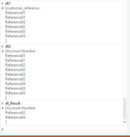

Hey @Josh_James
Here is the Solution!
Use Below mentioned LinQ:
dt_Result = dt2.AsEnumerable() _
    .GroupBy(Function(row) row.Field(Of String)("Account Number")) _
    .Where(Function(grp) grp.Count() > dt1.AsEnumerable().Count(Function(row) row.Field(Of String)("customer_reference") = grp.Key)) _
    .Select(Function(grp) grp.First()).copytodatatable
Note: Above LinQ will give you rows which are not there in Dt1 and repeated more times then Dt1,
Values(Rows) will be only One time not as many times as it is present in Dt2, you can use new datatable rows for filtering and build further logic.
Immediate Panel:
