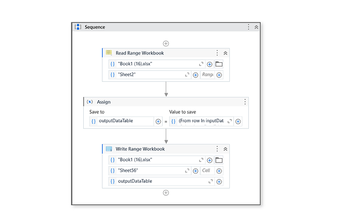

Can you try the following?
Code:
(From row In inputDataTable.AsEnumerable
Select inputDataTable.Clone().Rows.Add(
row("S.No").ToString,If(String.IsNullOrEmpty(row("Date").ToString), "", DateTime.ParseExact(row("Date").ToString.Trim, "yyyyMMdd", System.Globalization.CultureInfo.InvariantCulture).ToString("MM/dd/yyyy"))
).CopyToDataTable()
Input:
Output:
Sequence.xaml (13.7 KB)

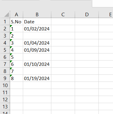

I have 3 columns for which I have to convert it to req date format: Date_1, Date_2 & Date_3
Meanwhile sample input:

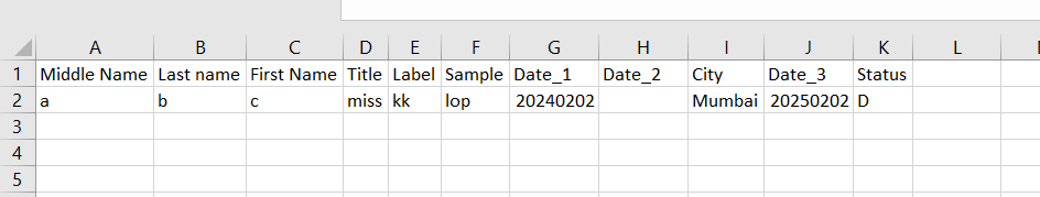

lrtetala
(Lakshman Reddy)
January 10, 2024, 11:58am
11
@smritijoshi
Can you please confirm about the H column date is 00000000
smritijoshi
(Smritijoshi2709)
January 10, 2024, 12:10pm
12
Sorry. Please Consider it as blank cell

Input:
Output:
