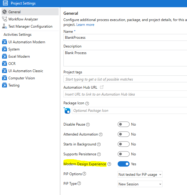

Hi @poojaskyrathore ,
Is it possible for you to use the Modern Design Experience, then you could try the Format Cells Activity.

@poojaskyrathore ,
As mentioned already, it will be available once the Modern Design Experience is enabled. You can enable this feature from the Project Settings Panel.
If you are still not able to get the activity, let us know the version of UiPath Studio that is being used.

my general setting is like this
You can find the project settings as shown in below screenshot,
