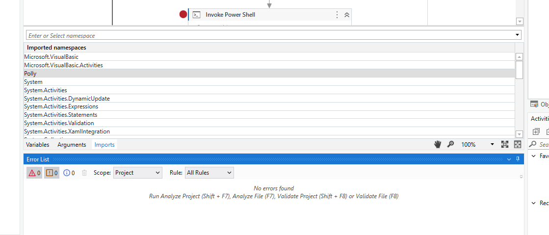

Is this the “imports” tab you are referring to, Pratik?

The error doesn’t indicate that anything is missing. The error is pretty clear - somewhere there is a value of one type trying to be assigned to a value of another type.
If you do think so, you could be a little bit more useful by helping us to identify that supposed assignation.
No, there’s no value assignation anywhere whatsoever.
By the way, I managed to change the error message if I change the “TypeArgument” property from the properties tab, to that one selected there instead of “System.Management.Automation.PSObject”, yet there’s no “Microsoft.TeamsCmdlets.Powershell.Connect.Models.PSAzureContext” type I could select there.
There’s your assign. That property determines the datatype of the currentItem variable, which later affects assigning or using values.
