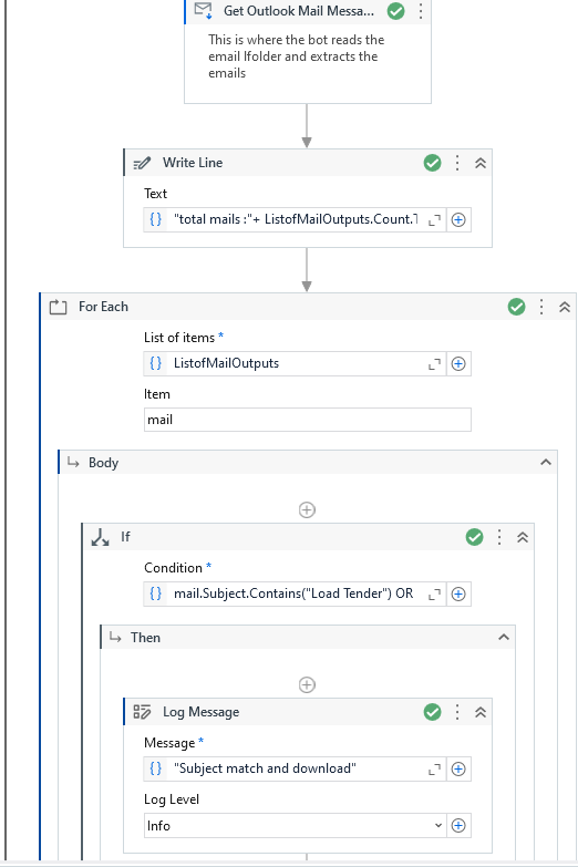

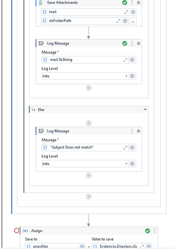

Here is my flow i keep getting this error when i run it, but if i run it from the assign activity it works. Do i need to do it with the API to stop getting this?

Please change the scope of the variable you are having issue with…unserializable variables cannot be used in same scope as persitent activities
Hi @trogers
Take a look in Best Practice section
So as @Anil_G mentioned, you need change the scope of your unserializable variable like surrounding it with a sequence and change the scope to that sequence scope, for example
