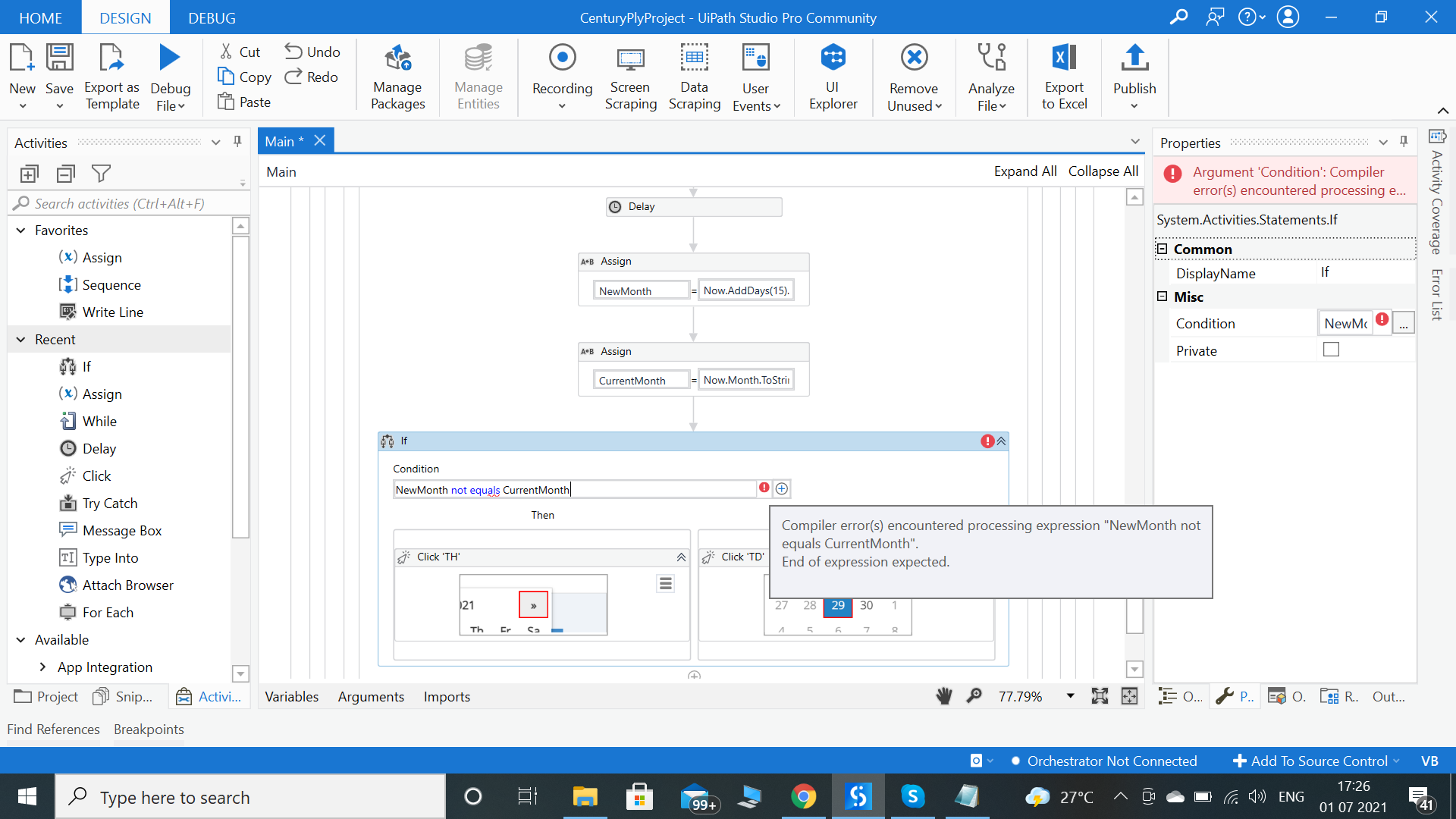

The following error occurs after giving the condition. What is the correct approach to write the condition??
NewMonth <> CurrentMonth
<> is the comparision operator for “not equals to” in VB
