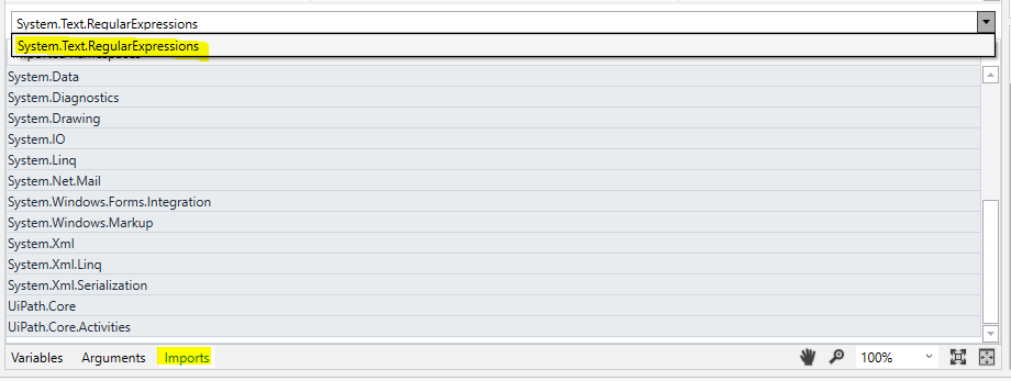

Ok I am using this expression in a different workflow, now it says “Regex is not declared. It may be inaccessible due to its protection level”. How do I resolve this?
import the namespace in your project
System.Text.RegularExpressions
How do I import namespace?
Hi @DEATHFISH
This should help:
