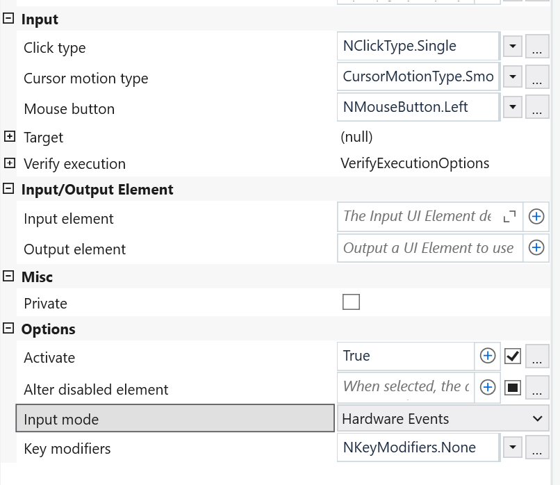

The website is detecting the automation. Try using Cursor Motion Type = Smooth with Input type = Hardware events or Windows Messages

I tried these options in properties panel still the CAPTCHA field appears.
