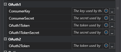

There are some fields to enter the information, but I put the credentials into the body. Like this:
varBody: “{”“client_id”“: ““APPID””,”“client_secret”“:”“APPSECRET”“}”
