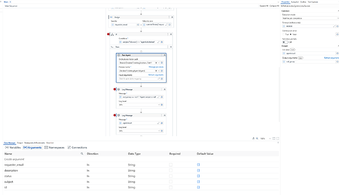

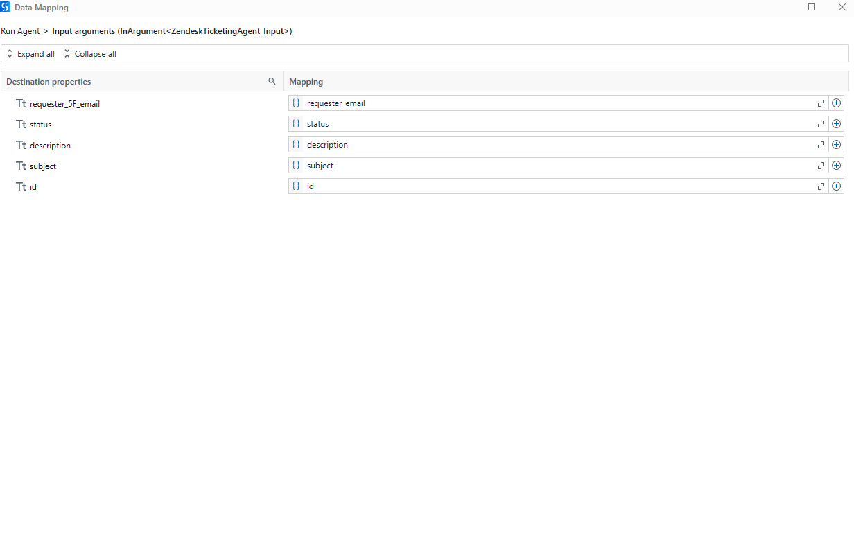

I am creating a process where I am invoking a bot and then passing its value 1 by 1 to the agent using a for loop. I am then invoking the agent by using the “Run agent” activity and passing the input parameters as shown in the screenshots. I am getting null as the output from the agent (out_group).
I have attached screenshots from the UiPath cloud studio as well where you can see my input and output arguments for the agent. Also, the agent is running fine on UiPath cloud studio but I am getting null when invoking it on UiPath studio app.

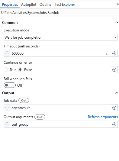

@Mir.Jasimuddin I am capturing agent’s output into an “Out” argument out_group like this:
but its returning null

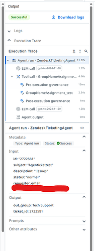

@Mir.Jasimuddin thanks for clarifying. Here’s what I get when i run the agent. I’m getting out_group value in the agent as expected at the bottom.
Also, I have defined the output arguments like this:
Please note that the agentresult which is the JobData is also being returned as null when I tried capturing it in finalValue like you suggested.
Let me know if i need to make any changes to this.
Hey @Parth_Sharma, can please check the bellow points:
  1. The issue is with the activity you’re using.
    You’re using the Run Job activity from UiPath.System.Activities, which is meant for standard processes, not for agents created using Agent Builder.
  2. Use the correct activity.
    Install and use the Run Agent activity from the UiPath.Agent.Builder package. This is specifically built to handle agents and return outputs like out_group properly.
  3. Map the result correctly.
    After using the correct Run Agent activity, assign a variable (like agentResult) to the Output > Result field. Then, extract the value using:
finalGroup = agentResult("out_group").ToString
  1. Retest your process.
    Once you switch to the right activity and set the output correctly, your agent’s output should come through as expected.

@Parth_Sharma
Can you open advanced wditor for arguments and use the below expression to pass your arguments Instead of using data mapping please..are you on a studio version less than 25?
New Email_Rewriter_Input() With {
    .feedback = "sample feedback",
    .originalEmail = "sample email content"
Also please turn on fail when job fails so that if there is any error it would throw as well
