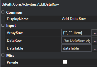

Try below steps.
        For Each item in Brand
            -Use Add DataRow activity and pass below values to it
         ArrayRow - {"","",item}
         DataTable - varDataTable
Where varDataTable is output of your Build DataTable activity

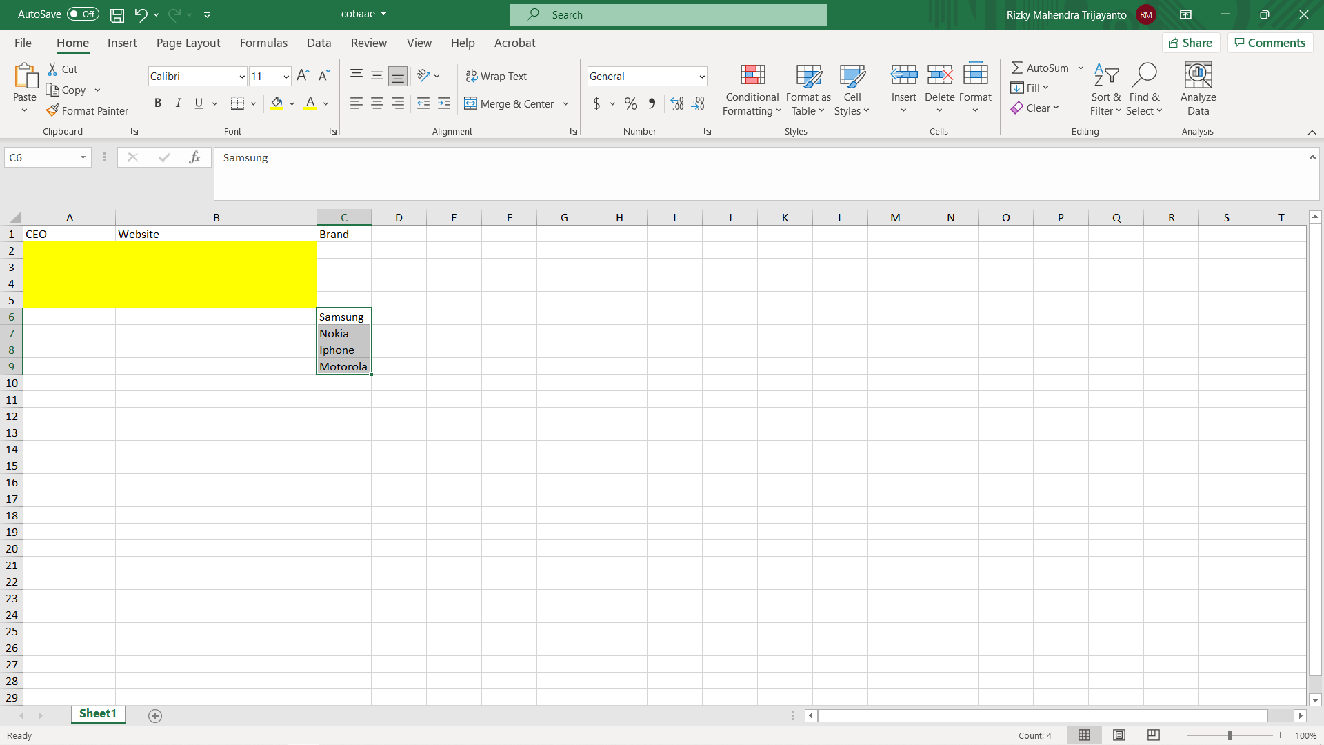

I want to add all Brand value to specific column, that is “Brand” Column
Do you want to have this
or this
The first one
Then use lakshmans description, it’s exactly what you need…
If you’re a picture guy, here:
image image

I have tried using for each.
I forget to say that, I’m using assign activity to add 2 variable (string of array) to add values to CEO and Website column. After using the for each activity, this is the result of the program. The value of Brand Variable begin to be write add 6 row.
So don’t use add row which - as the name implies - adds a new row, but rather go through the datatable with for each row and assign everything in there.
But to be honest, you give us very little information somehow expect us to figure out what your problem is.
Show us what you’ve tried and what your problem is. Everything you want to do can be solved with for each (row) loops and assign activities.
