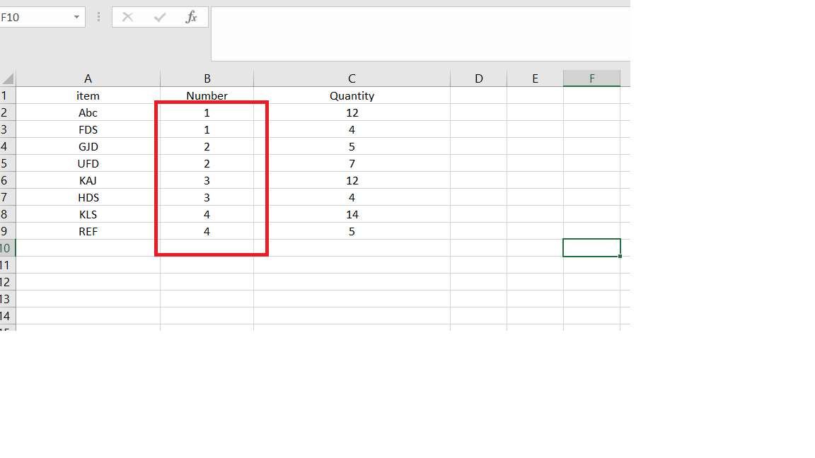

Hi Everyone.
I have datatable as attached excel file.
I want to add sequence number into rows as attached picture.
How to do that without loop row in datatable?? Such as Linq
Thanks in advance!

Hi Everyone.
Thanks in advance!

Do you want to flll it at blank Number column? If so, the following helps you.
dt.AsEnumerable.Select(Function(r,i) dt.Clone.LoadDataRow({r("item"),Math.Floor(i/2)+1,r("Quantity")},False)).CopyToDataTable

Thanks you very much!
