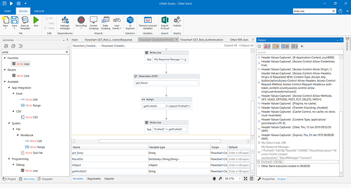

Here is the workflow for the JSON you provide in the previous reply…
JSON.xaml (5.2 KB) project.json (900 Bytes)
Hi Hareesh,
I got it…
In that For each loop , you have to give the input as JObj.Root …
But you are trying to get the Profile ID right?
Then you have to give it as JObj.Root(“ProfileID”)
Refer the screenshot
OK Got it I will try that with .root…
many many thanks …:slight_smile:
Appriciated for your time…:slight_smile:
